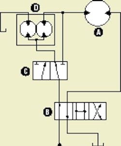

In normal operation, the circuit routes hydraulic fluid at system pressure to motor A through valve C. In high-pressure mode, valve C routes fluid through flow divider D, which intensifies pressure to motor A. ...
A gerotor-type flow divider provides simple, controllable intensification in the hydraulic circuit patented by patent agent George Morgan, P.E., Evansville, Ind. For example: if hydraulic motor A is the actuator (right), 3-position valve B selects the motor's direction of rotation. As pictured, flow passes through valve B and bypass valve C to drive the motor at the circuit's lowest pressure. Flow divider D is idle.
For higher pressure, valve C shifts to direct flow to the flow divider (far right). Output flow from the left-hand section of the divider is dumped to tank. Because the two flow divider sections are mechanically connected, the pressure drop across the left-hand section converts the right-hand s ection to a pump. Flow to the motor from the right-hand section is pressure-intensified.
In this simple example, if the two sections of the flow divider have the same displacements (for equal flow), the new flow rate to the motor-will be one half of the original – at double the pressure.
