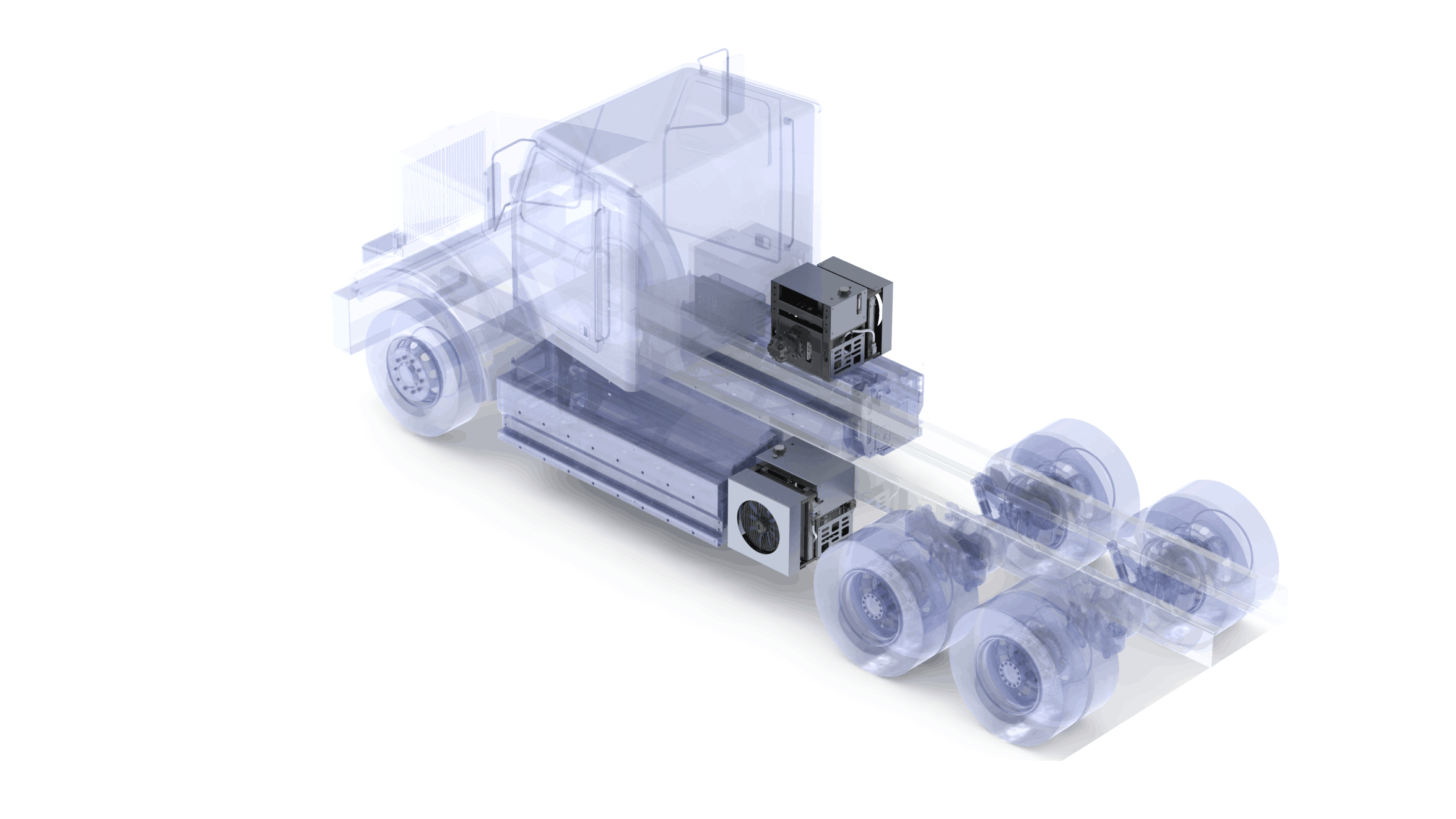

Unlike a traditional PTO which takes power off a transmission, driveline or other place where rotational energy occurs, ePTOs get power from the vehicle’s power distribution unit (PDU) said Parker Chelsea during a presentation on ePTO technology at The Green Truck Summit 2024.
The PDU is connected to the batteries to send power to the drivetrain, air conditioner and other auxiliary functions. An ePTO can also gain power from the PDU and transmit it to an inverter – where direct current (DC) input power is output as alternating current (AC) – a motor and a hydraulic pump which then drives the vehicle’s hydraulic systems the company explained.

Ghajari said ePTO systems are more complicated and contain more parts than a traditional power take-off, so there is more integration and OEM involvement required. The additional parts in an ePTO system also means there is more space required, necessitating collaboration to ensure proper packaging on the vehicle.
He said ProDrive is working to simplify ePTO designs but there are some technological restrictions. For instance, electric motors and inverters above 20 kW require a separate cooling system. Here again it will be necessary to collaborate with OEMs to determine how to address this additional cooling need.
There are some approaches in the market under development; in Europe, some OEMs are increasing their cooling power 10 kW which then provides enough cooling for the ePTO as well. Another possible consideration is for PTO manufacturers to package the motor, inverter and cooling into a single standalone unit, but again Ghajari said there are technology restrictions associated with this approach such as cooling the inverter. Electric motors have reached a point in which they can be oil cooled but it is not currently possible to reach good efficiency levels with just oil cooling an inverter, he said.
Gulick noted that ePTO technology is so new and changing so rapidly that sometimes Eaton must make changes midway through the development process. In one example he shared, the company had an ePTO design ready to go that would be packaged right behind the cab of the truck but then the customer said it needed to bump out its frame rail, requiring a complete change to the packaging.
