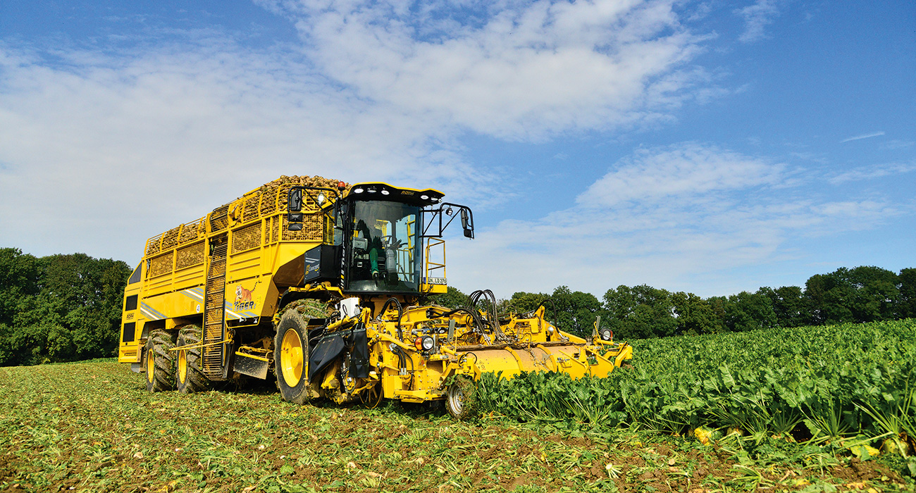

The Tiger 5 sugar beet harvester exemplifies the next generation of equipment to be put to work under such increasingly diverse conditions.  This 15-meter-tall machine’s stepless drivetrain and hydraulics enable sure-footed operation, even on slopes. Its engine can perform at 617 hp with displacement of 15.6 l, and can propel it at up to 40 km per hour when empty. Under load it can support a curb weight of 33 tons, and a payload of more than 30 tons.
Two adjustable motors and a constant-speed motor work together to help this harvester achieve maximum traction force without losses.
To accommodate those hillsides, this three-axle beet harvester features stepless travel drive and automatic, hydraulic slope compensation (earning it “Machine of the Year 2015” in its category at the French SIMA trade fair for agricultural technology).
