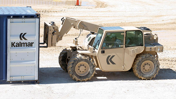

Kalmar Global's RT022 rough-terrain telescopic forklift is compact enough to drive right inside a container, and has a 5,000-lb. lifting capacity.
Kalmar’s RT022 rough-terrain telescopic forklift relies on Eaton’s DuraForce pumps and motors for hydrostatic ground drive that transmits power to axles for two- or four-wheel drive.

Kalmar Global manufactures a wide variety of off-highway equipment, including the RT022 rough-terrain telescopic forklift. Compact enough to drive right inside a container, it features two-wheel, four-wheel, and crab steering modes for excellent maneuverability on the most challenging surfaces. With side-shifting forks for container loading and unloading, and a tight turning radius of just 30 ft., the RT022 is well-suited for lifting operations in tight spaces.
With a lifting capacity of 5,000 lb., the RT022 is used to handle ISO containers, which primarily contain supplies and ammunition for expeditionary operations. The machines are small enough to drive directly into a container and can ford water up to 0.9 m (3 ft.) deep.
The RT022 is powered by a 68-kW (91 hp) Perkins diesel engine, which drives DuraForce HPV pumps and HMV motors from Eaton Hydraulics, Eden Prairie, Minn.
