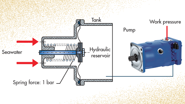

A pressure-compensation system exposes hydraulic fluid within the reservoir to ambient hydrostatic pressure, but a flexible seal prevents seawater and hydraulic fluid from contacting each other.

Pressure compensation is useful in any system that operates underwater. It’s used to keep the pressure between external environment (seawater) and reservoir constant, because seals are typically designed for a limited pressure drop in one particular direction. Most components readily available were designed for operation in normal surface environments. Almost all machines have sealing surfaces or other parts that cannot withstand high subsea external pressures or severe pressure drops.
Although complicated and expensive, one option is to seal pressure-sensitive components inside a protective chamber. This usually involves a container with rigid construction and heavy-duty seals to withstand the high external pressures. A more effective solution, however, is pressure compensation. With this technique, a pressure is applied inside the component that’s equal and opposite to the ambient pressure outside.
High velocity oxygen fuel (HVOF) gun and cobalt-alloy coatings applied via plasma arc welding are two coating types that improve tribological properties of piston rods in underwater-bound large hydraulic cylinders.
In a typical hydraulic system, the standard reservoir is replaced with a sealed reservoir containing a flexible medium separator. Therefore, the external environment pressure transfers to the reservoir, just as a normal surface system has the external air pressure on top of the oil in the reservoir. The difference is that it prevents the seawater from mixing with the oil.
This clever system allows any component used on the surface to be used subsea, as long as all volumes that normally contain air can be vacated of air filled with fluid and connected to the reservoir to maintain the pressure balance.
