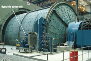

Spring-applied, hydraulically released brakes on this huge grinding mill can bring it to a halt from full speed in less than 2 sec. Each of two mills uses four sets of caliper brakes and has its own hydraulic power unit.

Twiflex Ltd., Middlesex, England, recently supplied its largest grinding mill braking system to Metso Minerals for installation on Boliden’s mills. The Twiflex braking system is designed specifically for mine grinding mill installations and provides both static and dynamic braking functions. In static operation, the braking system holds the mill during liner replacement and for general maintenance. For dynamic operation, the system can operate in two modes: stopping the mill from full speed in an emergency due to bearing lubrication problems or power failure. Dynamic braking requires a controlled application of the brakes, but for inching, the brakes are operated quickly to give accurate stops needed by the mill operator.
Twiflex supplied eight VMS-DP brake calipers with pedestals for the project, plus a hydraulic power unit for each of the two mills. The Twiflex VMS-DP caliper has an adjustable braking force from 590 to 737 kN and is a floating spring-applied, hydraulically-released brake for disc thicknesses from 117 to 130 mm. The hydraulic power unit offers a versatile brake control by allowing both local and remote operation for inching duties through a control panel.
The braking system at Boliden can generate up to 38 MN-m braking torque for each mill acting on a 12.97-m mill disc diameter. Each VMS-DP caliper weighs 1.85 tons and can deliver 940 kN clamping force. Even with a full process charge of 1375 Mg (3,025,000 lb) in the mill, the braking can stop the mill in less than 2 sec.
