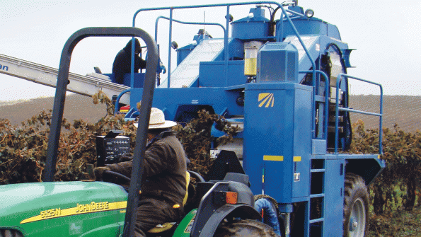

Oxbo 316XL grape harvester is configured as a 6-ft, 6-in. high, 32-in. wide, 11-ft long picking tunnel that straddles the vineyard trellis.
Oxbo’s Model 316 grape harvester is designed to be towed behind a tractor. The machine straddles the vineyard’s grape trellises while the tractor’s PTO powers two pumps for two harvester functions via a double gearbox on the hitch. (Oxbo also offers a self-propelled version, the 3016 XL.) Most tractors have a 3-point hitch, which can support a cantilevered load. The Oxbo harvester connects to only the two lower hydraulic links. These links actually pull the harvester and support its front end while the wheels support the rear. With this arrangement, the PTO shaft always stays pointed at the tractor. When the tractor goes through a dip in the field, the angle of the PTO shaft will change only slightly.
The Model 316 requires a tractor of at least 75 hp. About 30 hp is used for grape picking, cleaning, and conveying. Wheel drive assist — depending upon the grades it must climb — might consume another 30 hp intermittently. In addition, a 75-hp or larger tractor has enough mass to effectively manage the 10,600-lb harvester.
Double gearbox on grape harvester’s heavy-duty hitch drives two pumps for separate hydraulic circuits from tractor’s power takeoff.
