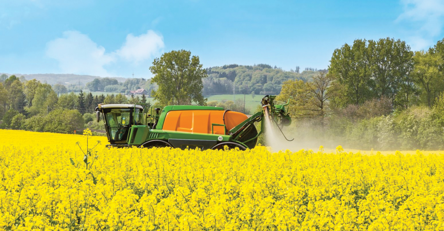

Using multiple hydraulic pumps, motors, and cylinders for essentially every operation of a crop sprayer requires careful selection of components and coordination of their operation.
Experts at Motrac Hydraulics B.V., a distributor and system integrator headquartered in Baak, The Netherlands, recently developed the hydraulic system for a self-propelled agricultural sprayer. The machine requires precise coordination of operations to ensure efficient and consistent application of pesticides or other chemicals despite varying vehicle speed, ground conditions, and routes.
The sprayer has a tank capacity of 4,500 l (corresponding to a load of about 9½ tons) and boom widths from 21 to 40. It is powered by a 218-hp diesel engine and uses a twin-piston diaphragm pump to deliver up to 530 l/min of field chemicals. The engine also drives a hydraulic pump group, consisting of variable-displacement piston pumps and gear pumps.
The drive package uses pendulum tandem chassis with four-wheel drive and independent suspension on all wheels. The chassis, developed specifically for spraying machines, ensures that no motion from the vehicle is transferred to the spray boom. Hydraulics is used for adjustable track width of the wheels and machine height—versatility to accommodate different crops and conditions.
Motrac Hydraulics also designs and installs integrated hydraulic circuits (manifolds and cartridge valves) in-house for all pumps. Depending on the machine, the main pump is generally connected directly to the engine via a mounting flange, with subsequent pumps mounted behind. Motrac often performs this work in-house, furnishing the complete pump line and diesel engine assembly delivered as a unit to the equipment manufacturer’s production line.
This crop sprayer uses hydraulics for propulsion, steering, regenerative braking, and all operating functions.
