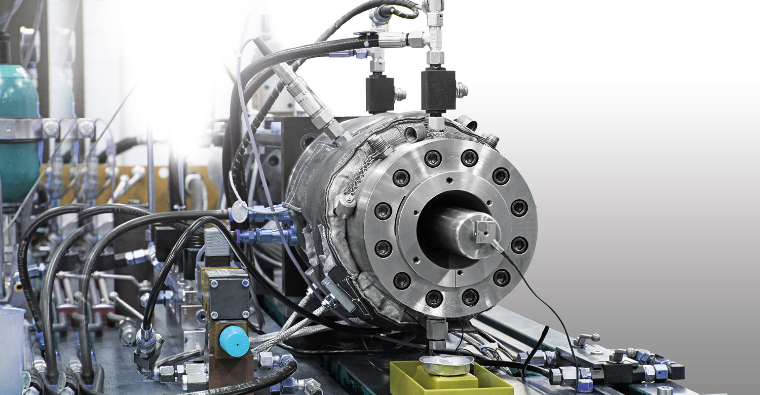

To measure the vibration frequencies in rod seals, a three-dimensional acceleration sensor was adapted on a test rig to measure vibrations that were expected to be multidimensional due to the play in the bearing of a rod within a housing.
The vibration frequency was calculated from the accelerations measured during the movement of the rod at different velocities while varying the pressure load. The test parameters were varied according to the defined test procedures. To produce the stick-slip effect, the measurement was made using a critical counter surface.
It became clear under constant testing conditions that the design and material of the seal exerts the main influence on the vibration frequencies. The sealing system tested consisted of a single-acting O-ring energized piston seal with a damping disk and radial pretension by way of an elastomer O-ring. The damping element was compressed by the seal when pressurized. Vibration with and without a damping element at O bar and 0.02 m/sec showed that the elastic behavior of the damping element in the sealing system significantly reduced vibration.
In piston seals, very smooth roughness profiles with a very low reduced-peak height—in combination with certain hydraulic fluids—can result in stick-slip and lead to noise. The same principle (as used in the rod seal) of adding a damping element can also successfully be applied to piston seals.
The proposed solution underwent extensive testing with successful results in reduction of noise and vibration. The new damping seal’s technology enhances the performance of hydraulic actuators (especially those of lightweight construction) while improving the user experience.
