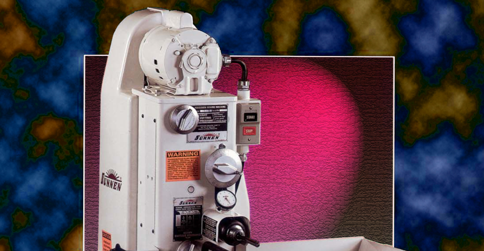

The tube honing process can be harsh, noisy, and prone to shock and vibration—sometimes violently. The machine (Fig. 1) puts two hydraulic axes to work: the feed axis and the stroke axis. The stroke axis is powered by a hydraulic motor and chain drive to move the honing tool (Fig. 2) on a drive shaft through the tube.
The feed axis moves a rod within the drive shaft to expand the abrasive tool at the end of the shaft to come into contact with the inside of the tube. The rotation of the honing tool (the spindle axis) is provided by a fixed-speed hydraulic motor and controlled by a PLC. The machine can push the feed rod, aided by mechanical leverage, to apply up to 3,000 lb. of force to the inside of the tube.
