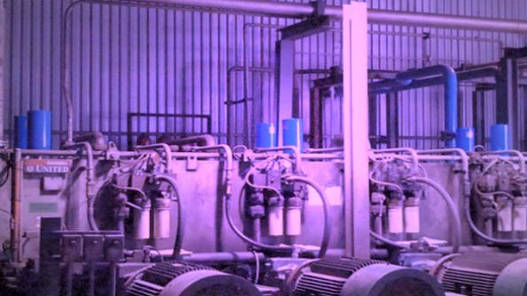

Even though the hydraulic system of a hot-roll plate mill contained multiple filters, contaminated fluid still caused unscheduled downtime.
Even though technicians had installed multiple hydraulic filters throughout this hot-roll plate mill, fluid contamination was still causing problems, so media were upgraded from cellulose to synthtetic microglass in all filter elements.
A single production operation breaking down at a steel mill can have a domino effect that escalates the cost of downtime. In one such case, operators were confident that the multiple filters they had installed at strategic locations throughout the mill’s hydraulic system would ensure maximum reliability. However, without regular sampling of oil and assessment of results, operators had no way of knowing how effective (or ineffective) their filtration efforts were.
The hydraulic system of the hot roll plate mill operated at a pressure 4,200 psi, and the working temperature of the fluid hovered around 130°F. An off-line (kidney loop) filter was provided for the reservoir, and filters were also located at the pump discharge for servovalve pilot circuits and for the return line. We recommended that technicians install several test ports and draw fluid samples to determine baseline ISO 4406 fluid cleanliness codes using an online particle counter. Based on these results, several other recommendations were implemented to improve cleanliness and reliability.
All filters were upgraded to Hy-Pro DFE elements using Grade 8 synthetic microglass media. DFE refers to elements rated by Dynamic Filter Efficiency testing. DFE surpasses current industry standards by quantifying capture and retention efficiency in real time, both by inducing dynamic duty cycles and by measuring performance during dynamic changes. It also measures that filter’s ability to retain particles. DFE testing is the method for predicting worst-case fluid cleanliness along with average fluid cleanliness.
Hypro 3M (β5 > 1,000) media were used on pump discharge, servo pilot, and recirculation filters. Hypro 25M (β22 > 1,000) media were used on the return line filter. We also advised installing Hy-Pro BF series high-flow, high-efficiency breathers with pleated microglass elements on the reservoirs to control ingression of fine airborne particulate.

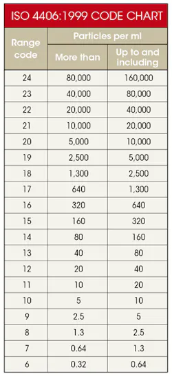

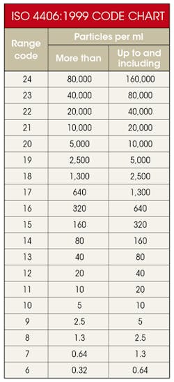

Understanding ISO Codes
ISO 4406: 1999 quantifies the concentration of contamination particles in fluid samples. Reducing the code number by a single number represents cutting the contamination concentration in half.
The ISO cleanliness code (ISO4406-1999) is used to quantify particulate contamination levels per milliliter of fluid at three sizes: 4, 6, and 14 µm. The ISO code is expressed in three digits (example: 16/14/11). Each digit represents a contaminant level code for the correlating particle size. The code includes all particles of the specified size and larger.
Note from the ISO 4406:1999 table that each time a code increases, the concentration of particles doubles. Likewise, the code digit by a value of 1 represents cutting the concentration of particles in half. Also be aware that new oil can be one of the biggest sources of particulate contamination. New oil often has an ISO code of 25/22/19 A good target for new oil cleanliness is 16/14/11.
Using the table, new fluid—with an ISO 4406 code of 25/22/19—would contain 160,000 to 320,000 4-µm particles, 20,000 to 40,000 6-µm particles, and 2,500 to 5,000 14-µm particles per ml. This is unsuitable for most hydraulic and lubrication systems. Instead, a good target for clean fluid would be 16/14/11: 320 to 640 4-µm particles, 80 to 160 6-µm particles, and 10 to 20 14 14-µm particles per ml.
