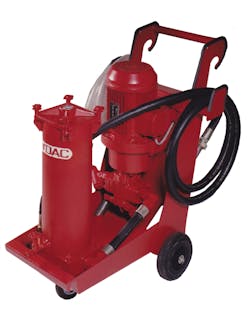

Mobile Filtration Unit—The system’s HYDAC OFU10 external mobile filtration unit (Fig. 6), has a constant displacement pump that runs at a speed of 1,500 rpm and has a flow rate of 100 l/ min. In one filtration cycle, it can filter all 2,000 l of oil in the 3-m3 HMO reservoir in about 20 minutes. The filtration pump cycles the oil through a 5 µm filter before returning it to the HMO reservoir.
6. In one 20-minute filtration cycle, the system’s mobile filtration unit can filter all 2000 l of oil in the HMO tank.
Detection and Trigger System—The detection/trigger system is activated by data recorded by the online particle counter, which causes the alarm LED to flicker when the contamination level exceeds the ISO-coded programmed limits.  To employ the alarm for contamination detection, a controller with dedicated logic must be interfaced with the particle counter. If the number of pulses exceeds the normal start-up number, the controller will send a trigger signal to an external relay that activates the filtration unit for a period of 20 minutes. Afterward, the controller sends a reset signal to stop operation of the filtration unit and reset the particle counter alarm.
