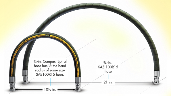

The higher flexibility of Compact Spiral hose allows bending it to a smaller diameter with no reduction in pressure rating. As shown here, the smaller bend radius allows using a shorter length of hose for most applications, and it also requires less bending effort.
