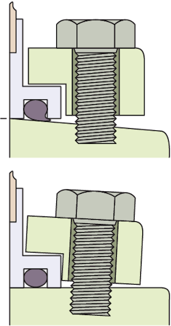

This cutaway illustration shows elements of a hydraulic flange connection.

In a properly designed split-flange assembly, the flange shoulder protrudes about 0.010 in. to 0.030 in. beyond the clamp face to ensure adequate contact and seal squeeze with the mating face. The clamp does not actually come in contact with the mating surface.
A properly designed and installed flange assembly will have a uniform clearance of about 0.010 in. to 0.030 in. between the port and clamp surfaces.
Unevenly tightened bolts may distort the clamp or skew the flange, causing the O-ring to leak. Likewise, over-tightening the bolts may induce bowing of the clamp, again compromising the integrity of the O-ring seal.
After a worker establishes that all of the mating parts are clean and suitable for installation, the O-ring must be lubricated, usually with system fluid or a light grease. This step helps keep the O-ring in place and prevents it from falling out during assembly.
The most critical phase in assembling a flange assembly is to tighten the four bolts gradually and evenly to ensure uniform tension among the bolts holding the joint together. The first step is to finger-tighten all bolts. Should one of the bolts be tightened fully while others are still loose, the mating surfaces will not be parallel. This will likely pinch the O-ring, compromising the integrity of the seal. Likewise, over-tightening the bolts can cause them to deflect downward until they bottom on the port face. This lifts the flange off the mating shoulder, raising the potential for leakage.
To overcome these potential problems, it’s best to gradually and evenly torque the bolts in a "cross" pattern. Air wrenches should not be used, because they are difficult to control and can easily over-tighten a bolt inadvertently.
