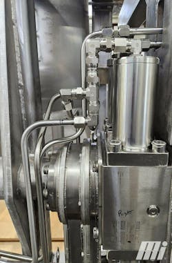

Switching From Linear Hydraulic Cylinders to Rotary Actuators
The key advancement creating the “magic” was in the creation of a new circuit design. This involved replacing the elevator’s pair of linear hydraulic cylinders with rotary actuators specifically selected and configured to improve tipping force and motion.
Some advantages realized with the rotary actuators included:
  • Direct Rotational Force Delivery – Rotary actuators provide torque directly around the rotation axis needed for tipping the drums. This alleviated the force vector inefficiencies seen in the prior system.
  • Reduced Bearing Load – By delivering torque without relying on off-axis force components, the stress on bearings and torque tubes markedly decreased.
  • Compact and Durable Design – Rotary actuators often have more compact footprints and fewer linkage parts than linear cylinders using complicated lever arms, reducing mechanical complexity and potential failure points.
The new carriage design integrated the rotary actuators precisely aligned with the rotational bearing assembly. This arrangement ensured three key things — smooth, controlled tipping motions with optimally applied torque; improved mechanical robustness through balanced loading; and simplification of mechanical linkages, reducing maintenance demands.

After the redesign, the elevator carriage experienced no further mechanical failures related to actuation forces. Stress on bearing and torque tube assemblies decreased dramatically, extending their service life. Reduced mechanical complexity simplified routine inspections and maintenance.
Operational safety and precision also improved with controlled hydraulic flow, which eliminated sudden, dangerous carriage movements. Operators reported increased confidence in system response and predictability. The system accommodated variable dump speeds tailored to product characteristics, improving processing quality.
Over time, the rotary actuators in the carriage underwent further upgrades, including the use of improved actuator materials and seals that met stricter sanitary requirements typical in chemical and food-grade processing environments. Improvements in actuator components increased the carriage’s operational lifespan: Testing confirmed a 300% increase in carriage life, now exceeding 100,000 duty cycles with ongoing refinements.
