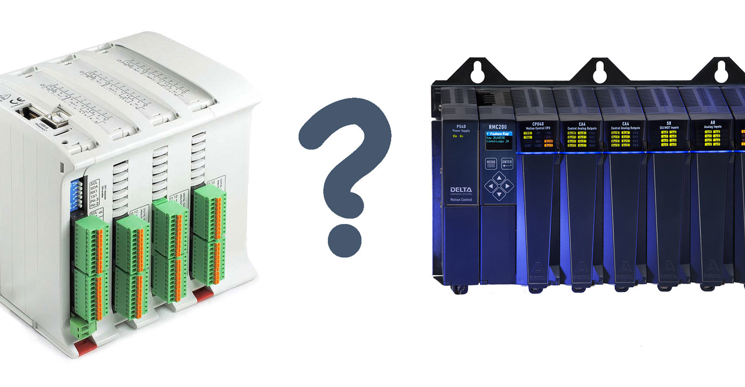

Some closed-loop motion control applications clearly call for a motion controller, whereas others can get by with using a PLC to close a control loop. Of course, reaching a decision often falls in a gray area.
Why should you spend money for an electrohydraulic motion controller when you might be able to use a PLC instead? The answer is not simple. In general, it is a function of quantity, degree of difficulty, available time, production rates, required precision, and economics. The decision can be quite fuzzy. From experience, we know which types of applications can be done using PLCs and which ones cannot.
Cost usually comes to mind first for most control system designers. The simple route is to buy a PLC with an analog input and output for each axis, some digital I/O, then start programming. You usually start out with a simple proportional control; a PID block isn’t even required. This is how hydraulic servo control is done in much of the world, and people who are taught hydraulics are taught nothing more.
