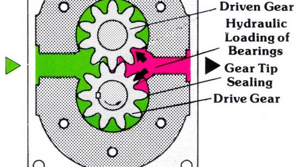

Commissioning didn't begin well. The rear section of the tandem gear pump that had been replaced, charged an accumulator. But we weren't getting any charge pressure on start-up. The direction of rotation of the electric motor was correct. But what about the rotation of the new pump? Bit hard to tell when it's submerged in the tank.
After speaking with the technician on my cell phone, I was reasonably confident the new pump's rotation was correct. But just to be sure, I decided to try reversing the rotation of the electric motor (not ideal BTW). No change.
Now what? I don't have a flow-tester with me and it's a major job to lift the tank lid. It appears that new pump is either faulty or not priming. Unlike a vane pump which sometimes needs a head of oil on its outlet for the vanes to 'throw' and start pumping, a gear pump is typically self-priming - especially when it's completely submerged in hydraulic oil.
To give the new pump the best possible chance of priming, I topped off the oil level at maximum. Still no charge pressure after running for a minute. In the absence of a flow-meter, I decided to lift the electric motor off its bell housing, disconnect the pipes from the pump's outlet penetrations in the top of the tank and turn the pump by hand.
This was revealing. The front section was pumping, but the rear section wasn't. Joy. The rear section was faulty. I continued turning the pump by hand, while I wondered what the chances were of this happening, and contemplated the work involved in lifting the tank lid.
Just as I was about to give up and call for reinforcements, I noticed oil was being displaced from the rear pump's outlet penetration in the top of the tank. It WAS pumping. I reconnected the plumbing, dropped the electric motor back into position and bingo. We had accumulator charge.
It seems the pump's rear section was 'air-bound'. Had I been told this story about a gear pump that wouldn't prime itself when submerged in oil, I would have struggled to believe it. Of course, all possible precautions should be taken when restarting any pump. Failure to do otherwise can result in a costly premature failure. And to discover six other costly mistakes you want to be sure to avoid with your hydraulic equipment, get "Six Costly Mistakes Most Hydraulics Users Make... And How You Can Avoid Them!" available for FREE download here.
