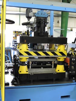

1. One segment of the metal stud manufacturing line engineered by TEKFAB is the slot press. In the press, hydraulic punches make two slot holes at a time, while the sheet steel passes through at about 200 ft/min.
This is the rationale that drove Albany, Ore.-based TEKFAB Inc., integrator of high-performance production lines, to use proportional valves and a programmable motion controller in a new line it developed for a manufacturer of steel building studs, Figure 1. Before roll-forming the edges of flat stock to make the legs of the studs, access holes are punched in the material using a compound die that first punches the hole and then forms the edges of the hole for strength—all during a single stroke.
Equipment used previously by the customer made the access holes via hydraulic rams operated by discrete directional-control valves. The gauge of the steel needed to be thick enough so that it wouldn’t tear radially to the desired cut outline when punched by the ram. Also, the speed of the punch was restrained to minimize any possible damage to the machine caused by the shock and vibration of the punching operation.
For the new stud production line, TEKFAB was given the task of speeding up the process, significantly expanding its automation capabilities, and making it more precise and repeatable. On top of that, the company had to deal with lighter-gauge steel than the traditional steel that was formed. “To meet these requirements, we knew that we needed to use an electronic motion controller,” said Rob Taylor, TEKFAB principal.
