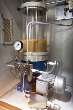

Lubrication strategy must support these material decisions. Excess grease attracts dust and turns it into abrasive slurry. Too little lubrication increases friction and heat. Controlled application is critical. Greases with solid additives such as graphite or molybdenum disulfide maintain boundary lubrication even when particulates enter the interface. These additives continue protecting surfaces after base oils thin or migrate.
Automatic lubrication systems reinforce this discipline by delivering small, consistent amounts of lubricant at regular intervals. This reduces buildup, limits variation and supports longer service intervals without relying on manual application.
Oil-lubricated systems require tight containment. Open oil baths rarely survive in abrasive environments. Enclosed gearboxes with circulating oil and fine filtration keep contaminants away from gears and bearings. Magnetic drain plugs capture metallic debris before it recirculates. Oil viscosity should match load and operating temperature to maintain a stable lubricating film without unnecessary drag.
