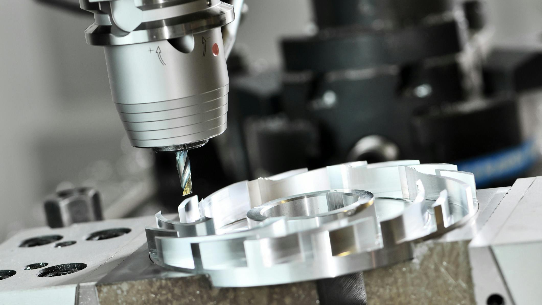

Surface Finishing Types and Their Impact on Motion Control Component Performance
Understanding the different types of finishing concepts utilized by manufacturers and how they can impact motion control component performance can help ensure the right option is chosen for a given application, assuring accuracy and repeatability are achieved.
Commonly used finishing concepts include:
- Surface roughness: Affects how components interact, with rougher finishes producing more irregular friction and potentially catching debris which results in unpredictable motion.
- Hardness and wear resistance: Includes coatings or processes that increase hardness and extend the life expectancy of moving components, with smooth, hard surfaces providing better dimensional stability.
- Dimensional precision: Involves honing and other finishing techniques for final tolerance, preventing deviations or irregularities that affect how gears and other parts fit together.
When selecting the surface finish to use, it is necessary to consider how it can influence friction and other performance factors.
Inconsistent or overly rough surfaces can result in varying friction as components move, increasing the risk of stick-slip behavior — moments of static friction and sudden movement. This makes positioning less accurate, creating more unpredictable motions.
Surfaces that are polished or smooth, on the other hand, help lower the risk of stick-slip behavior and positioning errors. These finishes allow bearings and other components to move and slide with steady resistance and greater predictability.
Abrasive textures, scratches, and pits are all examples of finishing issues that can negatively impact performance, as well, such as faster wear under load, resulting in uneven rolling paths or other problems that interfere with repeatability.
Proper finishing plays a vital role in maintaining the reliability of a motion control system over time. Advanced techniques like superfinishing or specialized coatings help prevent accelerated wear, improve load distribution, and provide stable repeatability.
At the same time, precision finishing supports tight tolerances, measured in microns, so high-performance parts like bearings fit together without gaps that compromise stability. Without this level of control, components may develop excess clearance that can lead to backlash or insufficient clearance which causes binding. Either outcome reduces accuracy and consistency.
By focusing on a finishing that extends service life, maintains tolerances, and prevents mechanical issues like backlash, engineers can improve motion control system performance across a wide range of applications.
Finishing Techniques to Consider for Improved Performance
There are several finishing techniques that can be used on the bearings, gears, actuators and other components in a motion control system to help improve their performance, ensuring accuracy and repeatability.
Grinding and Honing
Both grinding and honing produce surface textures that are more controlled and have refined dimensions, ensuring tolerance. They’re especially useful for components that require a high degree of precision, such as gear teeth and shafts.
Polishing and Superfinishing
Polishing and superfinishing help improve smoothness and decrease friction, allowing more precise movements for actuator rods, linear rails, and similar parts.
Coatings and Surface Treatments
Treatments and coatings, such as DLC (diamond-like carbon coating) or hard chrome, help surfaces resist wear while also reducing friction. Specialized treatments like anodizing protect components from corrosion and increase their hardness.
