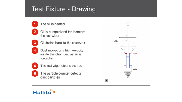

Shown here is a screen capture from the animated video demonstrating the rod wiper test procedure.

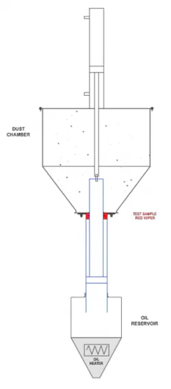

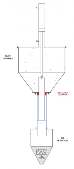

MSOE used the SAE J1195  standard combined with best practices to establish a baseline for developing the rod wiper test procedure. A rig was built in the MSOE test lab and parameters such as duration, cycle rate, pressure and temperature were set using input from hydraulic cylinder manufacturers to best simulate the rigor of actual field conditions. It took eight months of development, verification, trials and adjustments to establish a repeatable test procedure. Once the new procedure was completed and proven, MSOE tested the Hallite 520 and 820 wipers against two seals from other manufacturers.
The test procedure involved installing the rod wiper into the specified test fixture, heating the hydraulic circulation fluid to150˚F, pumping the oil over the top of the rod and letting it drain down into the reservoir while circulating high-velocity particles (ISO 12103-1-A4 Course Test Dust) of contamination in the chamber. The objective was to count how much dirt and grit got past the wiper. Based on the conditions and method used, data suggests that the Hallite 520 and 820 wipers allowed less than one half the amount of contaminant from entering into the test system compared to competitive wipers that were tested.
