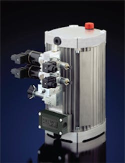

HAWE
Small and light KA power units from HAWE Hydraulics fit the tight confines of wind-turbine nacelles and generate pressures to 10,000 psi.
Unscheduled downtime in wind turbines is a leading reason why electricity generated from wind continues to cost more than that from conventional power plants. As one remedy, HAWE Hydraulics, Charlotte, N.C., recently introduced the type KA power unit specifically for use in wind turbines. It hydraulically controls yaw and rotor braking and reportedly increases the service life of costly components such as gearboxes and rotor blades. The units are compact and lightweight, install vertically or horizontally, and can mount right next to actuators, making them a good fit in the extremely tight confines of wind-tower nacelles. They can also be transported to the nacelle without a crane.
The hydraulic power unit includes a tank with an integrated submerged motor, a radial-piston or gear pump that attaches directly to the motor shaft without a coupling, and a connection block. Control modules mount directly onto the connection block and can be quickly exchanged by loosening four screws. There is no need to remove any hoses.
Steel construction lets the units withstand high pressures. The radial piston pumps supply pressurized oil up to 10,000 psi, while the valves are designed for pressures exceeding 5,800 psi. Because hydraulic pressure in wind power plants is typically below 3,600 psi, the pumps and valves operate with a high safety margin and are said to provide extremely long life.
For safety, brakes in a wind turbine must be reliable at all times. That’s why the HAWE system uses leak-free directional seated valves, according to company officials. The valves have a considerably higher switching reliability than typically found in directional spool valves, as dirt particles flush out when the valve opens. This design prevents silting that can cause spool valves to stick.
Three tank extensions on the KA provide oil volumes from two to ten liters. The power unit operates across a range of voltages, including 690 V, and is also available in a cold-climate version. HAWE offers active and passive brake control, with or without a flushing function for the brakes and brake lines. Additional modules are available for adjusting the pitch, roof openers for the turbine pod, rotor lock, and control of on-board handling cranes.
For more information, visit www.hawe.de
