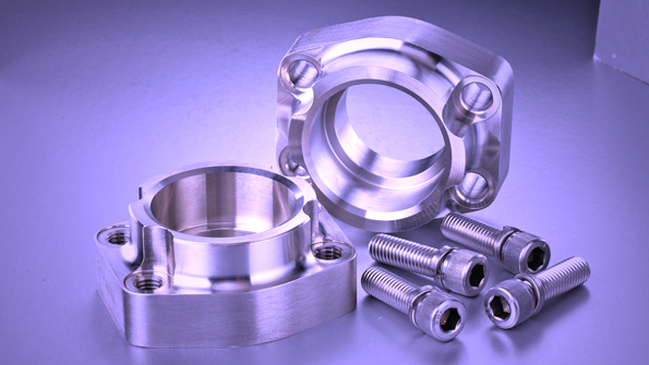

These components constitute a stainless-steel four-bolt deep socket flange assembly.
When properly selected, hydraulic flanges reduce the number of adapters used to plumb a hydraulic system. This, in turn, helps shrink system plumbing costs and minimize potential leakage. And their high reliability should make them the least of your worries if there’s a hydraulic system malfunction.
Four-bolt hydraulic flanges have long been a trusted connection for demanding high-pressure mobile and industrial applications.  The four-bolt flange design uses a quartet of fasteners to draw two mating flanges together. One flange contains a captive O-ring and the other a smooth machined surface, often referred to as flat-faced.  The four fasteners slip through the drilled clearance holes of the O-ring flange and screw into the threaded holes of the flat-faced flange.
When the four fasteners are properly tightened, the O-ring compresses against the flat-faced flange to complete the connection. Such a connection distributes the load across the four fasteners, reducing the likelihood of joint failure due to system vibration. The O-ring or flat-faced flange connections can be manufactured as single- or multi-piece components, where split or captive flanges encapsulate a flange head.

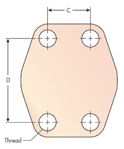

The most common four-bolt hydraulic flange connections are rectangular patterns conforming to SAE standards J518-1 and J518-2. Other patterns—ISO 6164, CETOP, and JIS—are square bolt patterns less frequently used in hydraulics.
The connections detailed in SAE J518-1 vary in size from ½ to 5 in., with maximum working pressures ranging from 500 to 5000 psi (3.5 to 35 MPa).  Typically, pressure ratings decrease with increasing connection size.  These four-bolt connections, commonly referred to as Code 61, are also compatible with bolt patterns designed to meet ISO 6162-1.
All of the bolt-pattern connections designed per SAE J518-2 are rated for a maximum working pressure of 6,000 psi (42 MPa).  Connections meeting SAE J518-2 range from ½ to 3 in.  Commonly referred to as Code 62, they, too, are compatible with a similar ISO standard—ISO 6162-2.
Although an overlap of sizes occurs between J518-1 and J518-2, the products are not interchangeable.  Bolt-hole spacing is slightly larger in the SAE J518-2 (Code 62) connections.  This difference helps prevent a lower-pressure flange from being installed on a higher-pressure pattern.
Also available for use with the SAE J518-1 and ISO 6162-1 four-bolt connection is a low-pressure two-bolt flange that’s primarily implemented in suction and return line applications.  These unique flanges are designed to be mounted diagonally on existing J518-1 patterns while using the same fastener sizes.  Their smaller size reduces material cost, weight, and installation time. Design specifications can be found in SAE J518-3.
Code 61 and Code 62 four-bolt flanges come in multiple dimensions.
