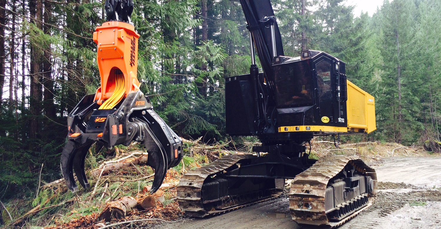

Promo Uea Swivel For Grapple 5dfa6befdb4bb
Rotary Unions and Swivels
