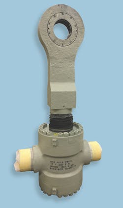

Mill-duty cylinders (Fig. 2) have flanges welded to the ends of the cylinder barrels with end caps of the same diameter as the flanges. Bolts secure the end caps to the flanges. Their construction is similar to that of welded cylinders, but mill-duty cylinders have thicker barrel walls and heavier construction in general.
2. Mill-duty cylinders have flanges welded to both ends of their barrel with an end cap bolted to each flange.
Large mill-duty cylinders often have a barrel wall thick enough for the end cap bolts to be threaded directly into the barrel wall. As the name implies, these cylinders were originally de-signed for use in steel mills, foundries, and other severe-duty applications.
