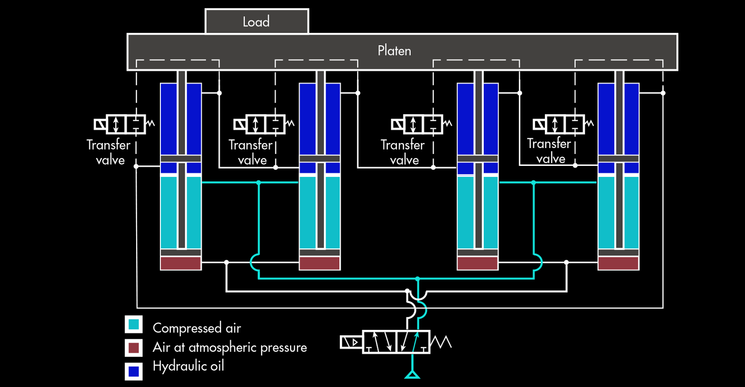

Figure 5 shows an accurate way of synchronizing two or more tandem air cylinders with fluid power. Four tandem cylinders are hooked to one platen, which will stay level throughout the stroke. Force from all four cylinders is available to move the load, regardless of its position.
5. Two or more tandem cylinders can be a convenient way of achieving synchronized motion. However, cylinders should be fully extended or retracted after each cycle to prevent accumulated positioning error.
Notice the transfer valves between the tandem cylinder’s cross port lines. Always return a fluid-type synchronizing circuit to a positive home position often, preferably after every cycle. When the air cylinders return the platen to home position, the transfer valves open to let the cylinders to re-synchronize. Doing this after each cycle eliminates any cumulative position error from seal leakage.
When using unmatched tandem cylinders in a synchronizing circuit, check for overpressure from intensification and load-induced pressure as already mentioned. Placing a heavy load over one cylinder provides pressure intensification from the other actuators. All other cylinders will transfer their excess energy through the oil lines to the loaded cylinder. The loaded cylinder could then push with four times its normal force. One-fourth of this force would be from its own air cylinder, whereas three times more force would come from energy transfer. This could overpressurize the cylinders or valves, causing failure.
