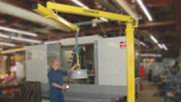

The Articulated Jib Lifter from Positech Corp. uses a Tolomatic cable cylinder to accomplish 120 in. of travel from a secondary arm that is only 130 in. long. As shown here the AJL assists in lifting and moving payloads, even if they are inside enclosures or other hard-to-reach areas.

Integrating a lift into the articulated jib arm provides additional overhead clearance and increases available reach. The lift also functions as a balancer, which provides additional functionality. This includes a load-sensing circuit to prevent accidental release of product being held by tooling; tool and payload balance circuits; and an up-and-down metering control.
The AJL uses an integrated pneumatic cable cylinder to provide a lift function. The lift cylinder is a single-acting Tolomatic cable cylinder that has been integrated into the outer arm of the machine. Routing compressed air to the retract side of the cable cylinder causes the payload to be lifted. Bleeding air from the cylinder allows the payload to be slowly and safely lowered.

The lift can be operated with a thumb-activated metering valve or as a balance lift for zero gravity. An operator can lift payload by using a metered or balanced circuit and manually float the object in the horizontal plane to the set down position. With optional tooling, payloads can be gripped, pitched, rolled, etc.
In addition, an optional safety circuit can sense cylinder pressure in a loaded and unloaded condition. The Positech Gripper Safety Circuit (GSC) option is designed to prevent accidental release of a load. When a payload is gripped and lifted, an increase in lift pressure due to the payload’s weight is sensed by the GSC, which in turn disables the release control. This effectively keeps the operator from accidentally releasing the payload until it is properly supported. Once the payload is properly supported, the lift pressure will decrease to a level at or below the empty tool weight sensed by the GSC. The release control is then re-enabled.
