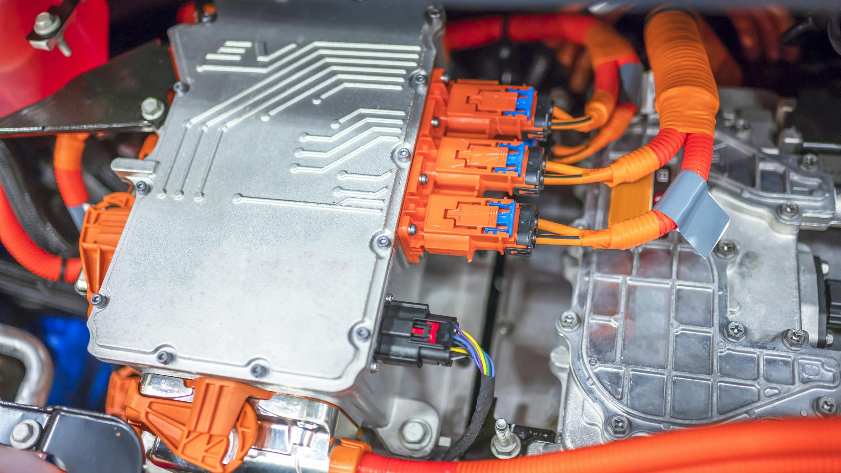

Addressing Unwanted Sound from Power Electronics
Somewhat ironically, lack of a combustion engine often accentuates noise from certain components — at least from an operator’s perspective. Whereas ICE masks various rattles and vibrations, quieter electric powertrains have prompted full cab redesigns to ensure better-quality driving experiences.
One common culprit is an EV’s power electronics, particularly during the switch-mode transformation phase, which can result in high-frequency noises. While not a significant contributor to external noise pollution, this noise can be bothersome to operators, reminiscent of the high-pitched whine from older plasma or LCD televisions.
To address this particular issue, OEMs should note the following:
  • Most commonly, the switched-mode power supply is the cause of this noise, produced by the switching frequency dropping below 20 kHz.
  • This noise does not necessarily indicate machine failure — simply an adaptation to the load and input voltage.
  • Utilizing Gallium Nitride (GaN) and Silicon Carbide (SiC) wide bandgap semiconductors may solve this, as they offer higher power and faster switching that often renders the frequency inaudible.
Once again, the solution largely hinges on quality; component selection is crucial, as is circuit design.
