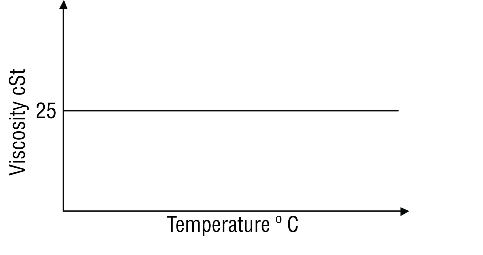

Whenever I present hydraulic maintenance training, a concept I always enjoy explaining to my students is what I call the perfect hydraulic fluid. And it’s very simple. The perfect hydraulic fluid would have a viscosity index (the change in a fluid’s viscosity relative to temperature) represented by a horizontal line intercepting the Y axis at 25 cSt, Exhibit 1.
Exhibit 1. Temperature-viscosity diagram of the perfect hydraulic fluid.
Of course, no such fluid exists and I don’t expect that such a fluid will be developed in my lifetime. But if such a fluid was developed, its creator would have the key to a gold mine.
Exhibit 1. A perfect fluid’s viscosity index would be represented by a horizontal line intercepting intercepting the Y axis at 25 cSt.

But exhibit 3 only tells us half the story. There’s critical information missing. We need to know what operating oil temperature equates to each of these viscosity numbers.
To establish this, we need to consider the weight of the fluid in the system and its viscosity index – represented by its gradient on a temperature / viscosity diagram. The flatter the line, the wider the allowable operating temperature range – for both optimum and permissible viscosity.
Here’s where the perfect hydraulic fluid comes in. If you could use a fluid that “flat-lined” on a temperature / viscosity diagram at 25 cSt, as shown in Exhibit 1, a significant variable is removed and problems arising from insufficient fluid viscosity are instantly solved. And that would we worth paying good money for!
