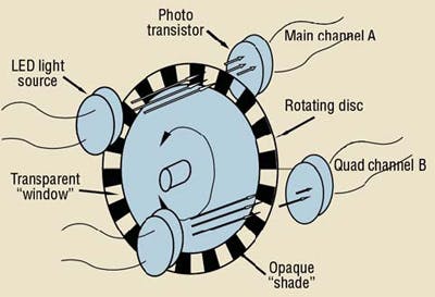

A simplified schematic of the incremental encoder is shown in Figure 1. It contains a thin disk with an outer periphery having a series of alternating radial segments of transparency and opaqueness. They are formed with great precision and repeatability. The precision with which the segments are placed has absolute control over the errors of the encoder.
A main light emitting diode (LED) projects onto the disk to detect whether a “window” or a “shade” is positioned in front of it. If a window is present, the transmitted light will impinge on a receiving phototransistor. The transistor conducts when there is light, and it shuts off when dark. When the input shaft is turning, the transistor current is a series of pulses of on and off, as shown in Figure 2, for the main channel.
Mechanically displaced by an integer number of radial segments, plus one-half a segment, is another LED-photo-transistor-sensing pair, called the quadrature channel, Figure 1. The quadrature channel produces a train of pulses that is displaced in phase by 90°, that is, when the main channel is high and at mid-pulse, the quadrature pulse makes a transition from high to low, as in Figure 2.
The use of the two channel encoder configuration is two-fold. First, with special signal conditioning circuits (not shown in any of the figures), edge detection can be implemented in which the ultimate pulse train consists of one pulse for each transition on each channel. That is, the leading edges of both channels can be detected as well as each trailing edge. This is called edge counting, and has the effect of providing four times finer resolution.
Second, a single train of pulses has no directional information. For example, if you observed the pulse train of either channel on an oscilloscope, you would not be able to tell which direction the input shaft was moving. However, when the quadrature channel is added, you can tell in which direction the disk is rotating. If the quadrature channel goes from high to low while the main channel is high, the shaft is turning forward. If the quadrature channel goes from low to high while the main channel is high, the direction of travel is backward.
Perhaps the most critical parameter of the incremental encoder is the number of segments per revolution. The one shown in Figure 1 has only 36 segments of alternating window and shade, which produces only 18 pulses per revolution. The resolution of the encoder is the reciprocal of the number of pulses per revolution: in this case, 1/18 of a revolution, or 20°.
The incremental encoder can be used for measuring position merely by counting the pulses fed into the electronic counter. But because a simple counter cannot distinguish direction of rotation, the direction bit from the fwd-rev logic module tells the counter to add or subtract the current pulse to the counter contents. Thus, the total count in the counter register is a measure of the total change in position since the counter was zeroed.
