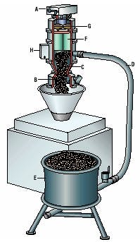

How a vacuum conveyor works
  1. Vacuum is generated by compressed air-driven vacuum pump A. The pump can be controlled automatically. Because it has few moving parts, the pump is virtually maintenance-free.
  2. Bottom valve B is closed, and vacuum is raised in  container C and  conveying pipeline D.
  3. From  feed station E, the material is drawn into the conveying pipeline and then on to the container.
  4. Filter F prevents dust and fine particles from being drawn into the pump and escaping into the surroundings.
  5. During the suction period,  air shock tanks G are filled with compressed air.
  6. When the material container is full, the vacuum pump is stopped. The bottom valve opens, and the material in the container is discharged. At the same time, the compressed air in the filter tank is released and cleans the filter.
  7. When the pump is restarted, the process is repeated, and a new cycle begins. The suction and discharge times are normally controlled by a pneumatic or electrical control system, H.
