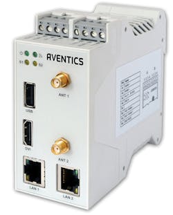

Densley: Yes, exactly. You can see the data today in your PLC and with a gateway like the Aventics Smart Pneumatics Monitor, which lets you analyze the data to create usable information to figure out what is going on with the machine.
