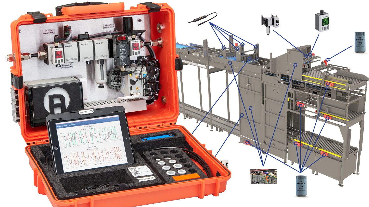

Let’s say you have a pneumatic packaging application and you’d like to leverage an IIoT solution to optimize energy efficiency. After consulting with solution providers, you may find that there are opportunities to enhance your results by also tracking performance of key components and overall machine health to maximize the useful life. This implies the need for continuous monitoring of air usage and performance/health parameters as opposed to a one-time, audit-style measurement/assessment.
Let’s assume that your facility has an existing data collection and analysis software platform, and your operations team agrees that air and performance data should be integrated into it. We now have some critical design criteria to work with, and your IIoT-enabled efficiency solution is well on its way to being realized.
Scope creep is a constant reality with any technology initiative; it’s already happened here in our hypothetical pneumatic monitoring application! We started with energy efficiency and now we’ve added performance and overall health monitoring to the equation. To implement a comprehensive pneumatic IIoT strategy like this, we will need more than just air usage data.

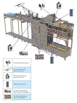

The palletizer application illustration shows a high-speed, bulk palletizer equipped with a comprehensive machine health monitoring solution from a leading solution provider. Capturing the necessary data for this application requires cylinder velocity sensors and mechanical cushioning wear sensors for lifecycle management, pressure sensors, vibration sensors and leak detection devices (such as air supply and consumption sensors). In this scenario, data from the network of sensors is analyzed by software running on an edge computer and insights are stored in an existing platform or data historian for machine learning purposes.
