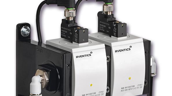

Safe exhaust is probably the most common pneumatic circuit used for machine safety. The circuit exhausts air from a cylinder or entire circuit to prevent trapping potential energy. Machine builders typically find that Category 3—which can cover a performance level a to d—is required. The function can be accomplished with an integrated device or by using standard off-the-shelf pneumatic components to ensure that machine safety has been optimized. Two 3-way valves in series exhaust compressed air from the circuit. Depending on the required performance level, the valves can be monitored directly with sensors that detect spool position or indirectly using downstream flow or pressure sensors.
Above is an example of safe dual-channel exhaust with 3/2 valves.
