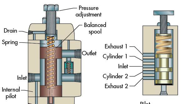

Figure 1 shows symbols and cutaways for hydraulic and pneumatic sequence valves. The main difference between these valves is that most hydraulic sequence valves are single purpose and must be used in series with a directional control valve. However, many pneumatic sequence valves are pilot-operated directional control valves with an adjustable spring return. In either case, a preset pressure must be reached before the valves allow fluid to pass or change flow paths. Many manufacturers offer a direct-acting, internally piloted hydraulic sequence valve like the design shown in Fig. 1. This valve can be changed to external pilot in the field if required.
1. Clockwise from bottom left are an ISO symbol for a bidirectional sequence valve; detail drawing of a hydraulic sequence valve; detail drawing of a pneumatic sequence valve; and an ISO symbol of a pneumatic sequence valve.
Many manufacturers also offer pilot-operated sequence valves. Pilot-operated sequence valves stay closed to within 50 psi or less of their set pressure. Direct-acting sequence valves may partially open at pressures that are 100 to150 psi below set pressure—and, thus, allow premature actuator creep.
A balanced spool—held in place by an adjustable-force spring—blocks fluid at the hydraulic sequence valve’s inlet. When pressure at the inlet reaches the spring setting, pressure in the internal pilot line pushes the spool up to allow enough flow to the outlet to keep pressure from climbing. Pressure at the inlet never drops below set pressure when fluid (oil or air) flows to the outlet. When outlet pressure exceeds set pressure, the valve opens fully, and pressure at both ports equalizes. The drain port hooked to the tank must be at no pressure or constant pressure because any pressure in this line adds to the spring setting. Again, a sequence valve always needs an external drain.
A bypass check valve accommodates reverse flow when the valve is used in a line requiring bidirectional flow. A sequence valve may be externally piloted from another operation in some applications. Most valves can be converted in the field. (The technician should always change the part number to reflect the conversion.)

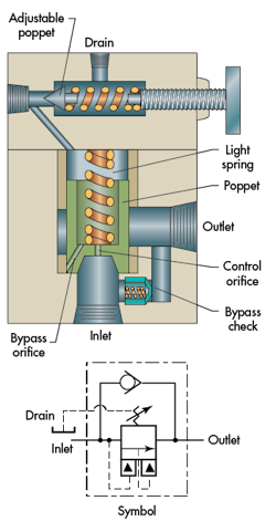

Sequence valves often generate heat because the first actuator to move takes higher pressure than the subsequent actuators. This means a high pressure drop usually occurs across a sequence valve, resulting in wasted energy. In some circuits, a kick-down sequence valve can reduce the energy loss. The cutaway view and symbol in Fig. 4 show the inner workings of a kick-down sequence valve to explain how it controls opening pressure and then unloads it.
4. A kick-down sequence valve uses internal bypass flow to reduce pressure drop, thereby reducing energy loss.
Fluid from the inlet flows through the control orifice and up to the adjustable poppet where it is blocked. The resulting pressure tends to open the main poppet, while equal pressure and a light spring acting on the opposite side hold it shut. When pressure increases enough to unseat the adjustable poppet—and more flow starts passing the main poppet than going through the control orifice—the pressure imbalance lifts the main poppet. When the main poppet moves enough to release trapped fluid through the bypass orifice, pressure on top of the poppet recedes because the bypass orifice is larger than the control orifice. At this point, the only force acting to hold the poppet shut is spring force and backpressure at the outlet port. When flow stops, the poppet closes again due to pressure equalization and spring force on the poppet.
5. The hydraulic circuit from Fig. 3 has been modified to now depict kick-down sequence valves. The pilot-operated check valve at the clamp cylinder’s cap-end port keeps it pressurized at near full force while the punch cylinder extends at low force. Energy waste is drastically reduced, as is heat buildup.Click on image for larger view.
The circuit in Fig. 5 is the same as in Fig. 3 except it incorporates kick-down sequence valves in place of standard sequence valves. The punch cylinder will not extend in this circuit until pressure on the clamp cylinder has reached 750 psi. The difference is when a kick-down sequence valve opens at its pressure setting, it allows fluid to pass at 50 psi plus whatever it takes to overcome downstream resistance. This means the whole circuit from the pump to all actuators is 50 psi plus the punch cylinder’s resistance. The pilot-operated check valve at the clamp cylinder’s cap-end port keeps it pressurized at near full force while the punch cylinder extends at low force. Energy waste becomes very low, so heat buildup is minimal.
