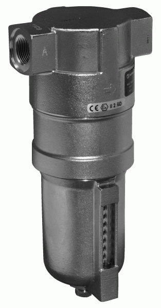

F22H stainless-steel coalescing filter protects sensitive equipment by removing oil from compressed hydrocarbon gas or compressed air in corrosive environments, such as offshore oilrigs, refineries and chemical plants. Half-inch ported filter features a large convoluted filter element, creating a large surface area to deliver high flow with minimal pressure drop. The filter is equipped with a stainless steel manual drain. It is also available with an automatic drain that opens when a specified liquid level is attained.
It is constructed of 316 stainless steel and its metallic parts meet NACE Standard MR-01-75, resisting sulfide stress cracking and discoloration in well-head and other corrosive environments.
Its maintenance cycle is extended when used as part of three-stage filtration system. Two general purpose filters placed upstream remove water and particles of 25 µm and then 5 µm before they can contaminate coalescing oil removal element. Three-stage system comes with brackets for panel mounting to fit into a compact footprint. Both the stand-alone filter and three-stage system are available with a stainless steel and nylon service life indicator that shows when the filter element is contaminated.
