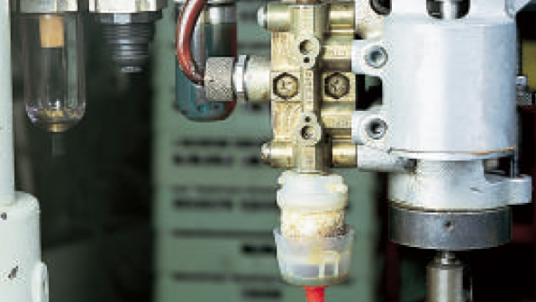

Installing a coalescing muffler (center of picture, near bottom) on plant equipment can reduce noise and residual oil emissions to below values mandated by OSHA. Filter-regulator-lubricator assembly is visible in left side of picture.

Exhaust mufflers have taken on greater importance with the enactment of OSHA (Occupational Safety and Health Administration) Standard 1910.1000. In part, the standard mandates that compressed air exhaust may not exceed 4.32 ppm of oil mist contamination in any 8-hr work shift of a 40-hr work week. In addition, noise may not exceed 90 dBA during an 8-hr day of a 40-hr week.
For decades, air exhaust mufflers have been used to reduce noise and emissions of compressed air exhausts. Now, however, specific guidelines exist. Internal geometry to reduce air velocity and baffles for audio damping take care of noise; filtration takes care of the oil. But not just any filter-muffler will do.
A standard filter-muffler has a porous element to trap any solids that may have been entrained in the compressed air stream. Porous elements, however, cannot trap vapors or liquids, such as oil. So unless the pneumatic system uses an oil-free air compressor and no lubricators, exhaust air should be routed through a coalescing muffler. A coalescing muffler operates on the same principles as a coalescing filter. As air flows through the coalescing element, oil particles are captured by three different mechanisms: direct interception, inertial impaction, and diffusion. In direct interception, oil particles simply collide with and are trapped by filter fibers. With inertial impaction, the element's turbulent air stream throws oil particles against fibers, which trap the oil. Diffusion causes the smallest particles to vibrate and collide with each other and eventually the element's fibers, which trap the oil.
Most coalescing mufflers have a port for draining collected oil from the element. Most also have replaceable elements that can be changed without having to replace the entire muffler.

Whatever the choice, mufflers that remove oil from the exhaust air should be considered — especially if air exhausts near workers. It is not uncommon for coalescing mufflers to remove 99.97% of the entrained oil. Even if oil-free compressors are used, exhaust mufflers can reduce noise to OSHA-acceptable levels and ensure that exhausted air is not only nearly oil-free, but clean.
