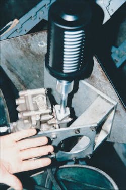

Just ask Northwest Airline's pneumatic shop manager Jacques Mezin and Fluid and mechanical accessories manager Robert Steele. Working in a shop-repair and overhaul facility for pneumatic components in the Northwest Airline's fleet, the two encounter a great deal of noise every day. "Testing air cycle machines, starters and flow pressure regulating valves make our facility noisy," explained Mezin. "We had one valve in particular that was very loud. So we fabricated an adapter to the valve port to try the muffler. We saw a reduction in noise of more than 30 dB, without sacrificing production."
Pneumatic muffler used by Northwest Airlines on a bleed control in the shop repair and overhaul facility reduces noise level from 107 dB(A) to 72 dB(A) when measured at 50 psi from 1 m away.
