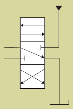

Most hydraulics courses include an example to illustrate an intensification problem that occurs when holding vertical loads with a cylinder. Typically, such an example might specify a cylinder with 10-in.2 piston and 1-in.2 rod lifting a 5-ton load. A blocked-center directional control valve stops the cylinder in mid-stroke. The student usually is told that the piston has a small orifice drilled through it. (A more realistic condition is the inevitable leakage past worn piston seals.)
At the moment the valve stops the piston, gauge A reads 0 and gauge B reads 500 psi. What’s the new reading on A?
The force on the piston now is the load plus a pressure component generated by 500 psi acting on the 9-in2 annular area—or a total of 14,500 lb. A pressure of 1450 psi in the cap end of the cylinder is necessary to support this force.
When the pressure at A rises to 1000 psi, the pressure component increases to 9000 lb—for a total force of 19,000 lb. Gauge B now registers 1900 psi.
The ultimate question is, “How far will this intensification progression go? What will be the maximum pressure in the cap end of the cylinder?”
One way to look at this problem is to recognize that the increasing pressure force on the annular area at the top of the piston gradually cancels the opposing pressure force on the annular area at the bottom of the piston. Eventually, pressure in the cap end intensifies — if the system doesn’t rupture first — to 10,00 psi, which will support the load by acting on the 1-in.2 section of the lower piston face opposite the rod.
This potentially destructive high pressure is the reason to avoid closed-center valves in circuits supporting vertical loads. One quick fix is to switch to a crossover center position valve to route leakage to tank. Another solution — often found in lift trucks — is an oversize rod to provide more bearing surface and less annular area. In systems where gravity lowers the load, intensification is avoided by venting the rod end of the cylinder.
