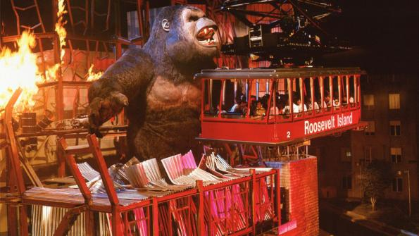

What do Tiger the Cat and King Kong have in common? For one, you'll find animated figures of both entertaining guests at Universal Studios Florida — Tiger is an animatronic character in Fievel's Playland, and King Kong is the centerpiece of Kongfrontation. For another, both use electrohydraulic proportional valves with on-board electronics to orchestrate a variety of lifelike motions.
Click on image for larger view.
King Kong uses standard Vickers valves, and Tiger the Cat uses standard valves from Parker Hannifin. If maintenance technicians had to replace a Parker valve with one from Vickers or a Vickers valve with one from Parker, the mounting footprint, plumbing configuration, port connections, or geometry of the electrical connector would not prohibit doing so. What would prevent replacing a valve from one manufacturer with that from another is pin assignments of the electrical connector.
