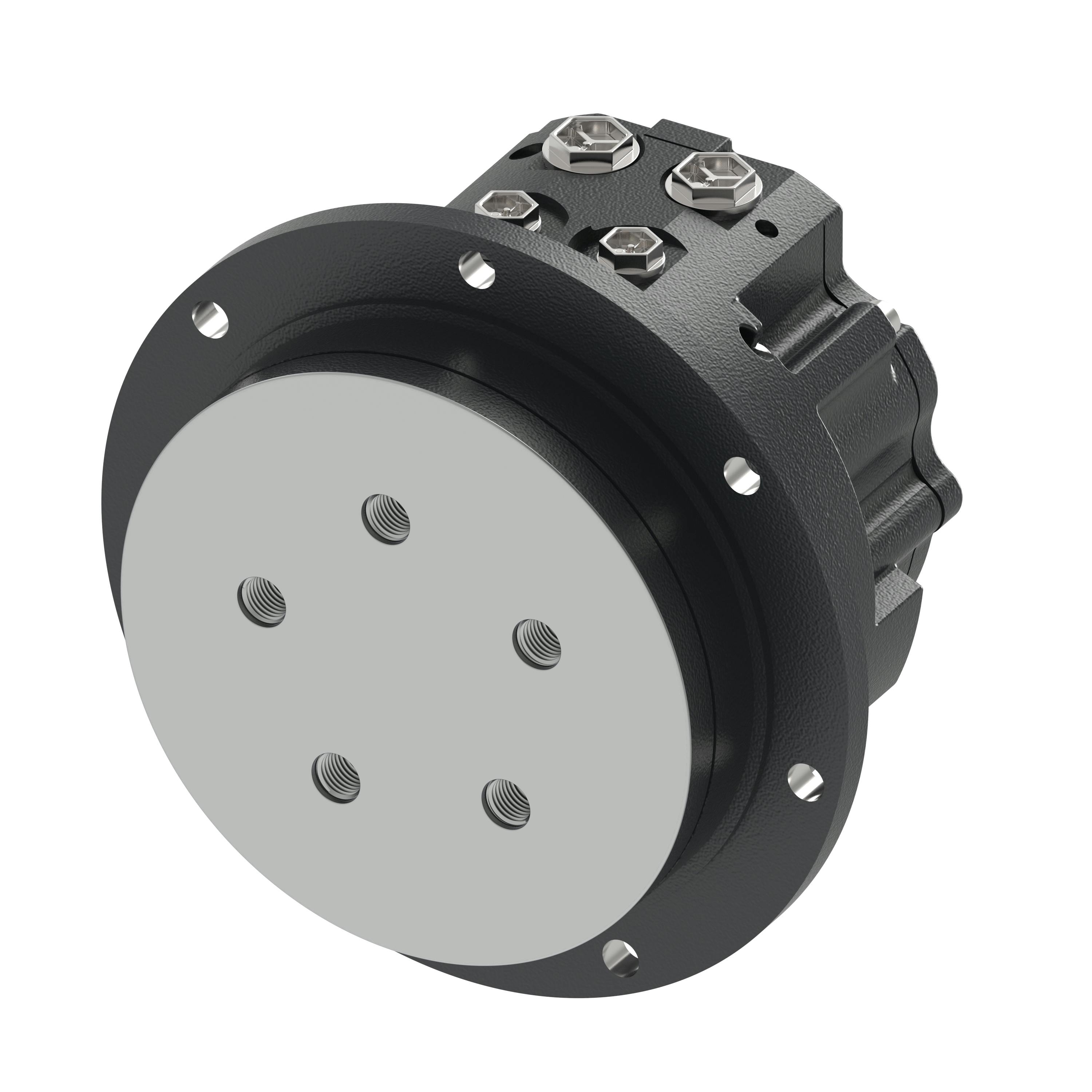

Durability, drivability and package size are core design elements for equipment manufacturers developing tracked machines. With these criteria in mind, Danfoss Power Solutions developed its BMV Integrated Drive Motor.
It is a two-speed axial piston motor with an integrated planetary reduction gearbox, designed for use in dual-path tracked machinery such as compact track loaders.

Compact System Package Eases Installation and Servicing
The BMV Integrated Drive Motor features a compact design, which helps reduce space claim on machines. “There's very little space in the undercarriage of some of these machines,” said Patwa. “And so, the more compact your product, the better off it is.”
Due to its compact and integrated packaging, installation and servicing of the BMV motor is made easier. Patwa said it was important to Danfoss to make both aspects easier for customers and machine owners.
Repairs and oil changes can all be made from the outside, eliminating the need to demount the motor. Concave areas on the drive mounting flange provide direct access to the motor fasteners, enabling installation and servicing from the machine’s exterior.
The BMV is also lighter in weight than other motors in its class, contributing to overall machine weight reduction, which can contribute to fuel savings and reduced soil compaction — an aspect that can be important in applications such as farming to prevent crop damage. The BMV 28/32-cc frame size is up to 14% lower in weight than similar motors, while the BMV 41/51-cc size is up to 13% lower in weight.

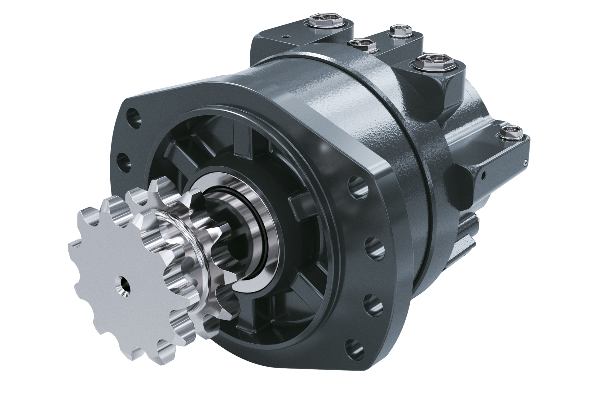

Choosing Between Integrated Drive Motors and Cam Lobe Motors
Patwa said the market for tracked machines is split between using integrated drive motors like the BMV and cam lobe motors. Danfoss offers both hydraulic motor technologies so customers can choose the option which best suits their needs.
He said cam lobe motors are commonly chosen for use in higher performance machines with higher duty cycles as well as requirements for high torque, high speed and low noise. “The cam lobe motor runs at roughly 30% lower speed than the axial piston motor, so it's significantly quieter,” said Patwa.

The CLM 8 S motor is for machines with chain drives.
The Thorx cam lobe motors feature a compact design and 5% higher efficiency to benefit construction equipment with chain drives.
