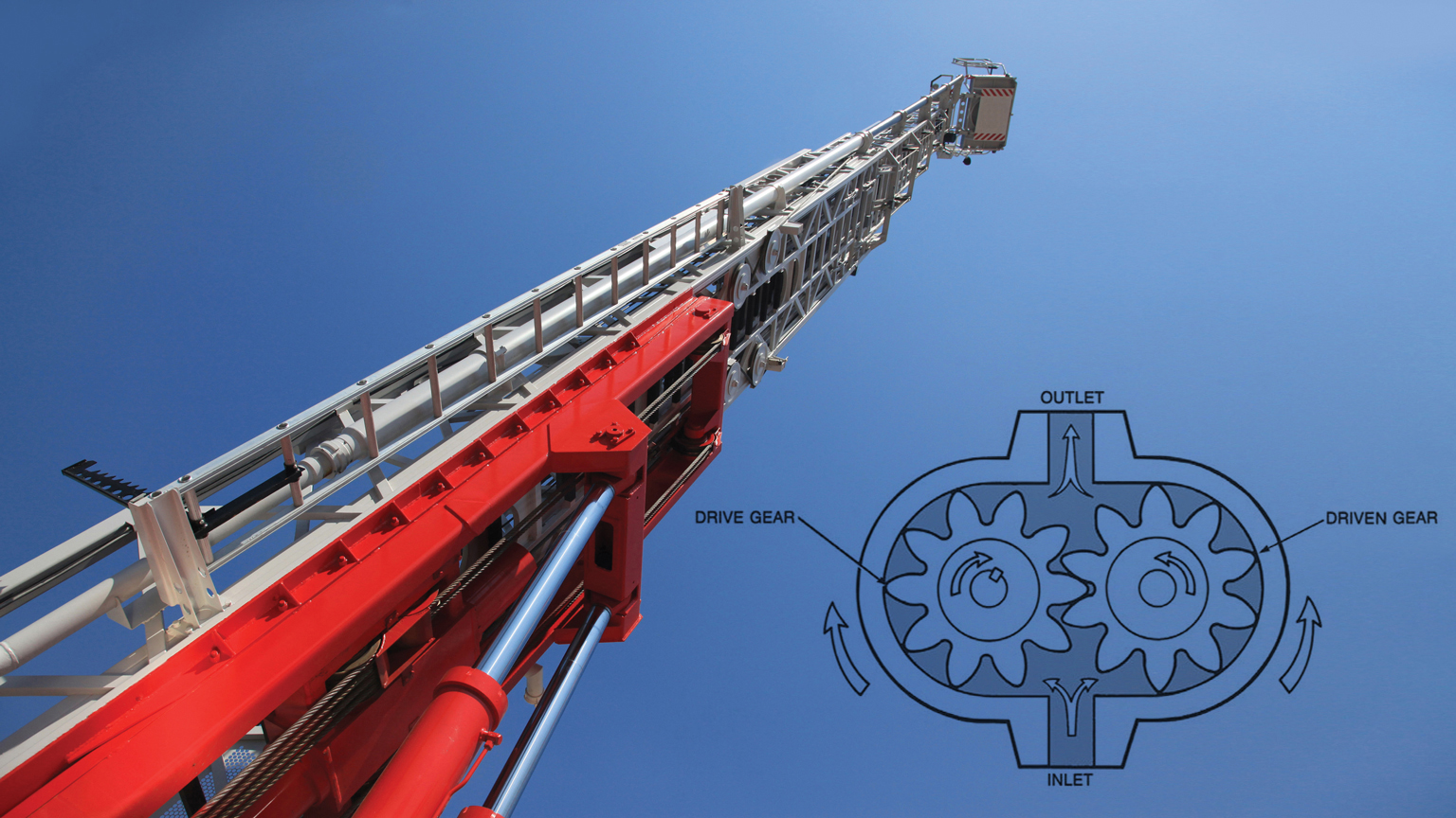

Gear pump: In external gear pumps, which are the most widely used positive displacement machines, flow is created by directing fluid around the perimeter of meshing gears.
The average efficiencies of 16 external gear pumps from seven manufacturers throughout the range of rated operating pressures and speeds were compared. The average volumetric efficiency for the 16 pumps was greater at 50°C than at 80°C across the board, but the mechanical efficiency of the pumps varied significantly between pump models.
Torque measurements as a function of pump speed generated some unexpected results. At low pressures (and thus low-torque values), the systems performed about the same at 50°C and 80°C. At higher pressures, however, there was less torque at 50° than at 80°C at all pump speeds, contrary to what is predicted by most textbooks. Pump outlet flow rate as a function of pump outlet pressure was greater at 50°C than at 80°C, and the difference was greatest at higher flow rates and higher pressures, in agreement with textbook predictions. All the gear pumps had a greater overall efficiency at the lower temperature.
