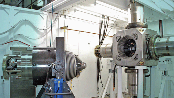

Variable-Speed Pump for 4,000-Ton Production Press
A “smart VFD-controlled pump” was applied on a hydraulic power unit for a 4,000-ton, solid-frame super-materials press, designed by Novatek Inc., Provo, Utah (Fig. 4). Novatek plays a leading role in the field of high-pressure, high-temperature materials engineering. The press features a cubic base with six cylindrical cartridges, each tipped with tungsten-carbide tooling. A work piece, which is a cell containing raw material, is placed in the center of the press.
4. Novatek’s 4,000-ton super-material production press integrates a smart VFD-controlled pump on its hydraulic power unit. (Courtesy of Sky Evans)
Inside the press, raw materials are subject to extreme pressure and temperature, similar to those found deep within the earth.  Chemical and mechanical transformations of the raw material require a certain time before completion of the process. This production process can take several minutes or up to hours, depending on the materials to be processed and size of the work piece.
Hydraulic presses that have long cure or forming times can benefit by using variable-speed pump drives. This is especially true when they require high forces but little movement (flow). During pressure holding, adjusting the pump’s speed and displacement results in significant energy savings as well greatly reduced system acoustic noise. In press applications, measured noise reductions between 10 to 15 dBA were realized as a result of variable-speed pump drives.
Novatek’s solid-frame press is powered by a 125-cc Rexroth DFEn variable-displacement pump, driven by a 100-HP VFD controlled ac motor. Bosch Rexroth and Womack Machine Supply teamed together to specify the right components for the application. Womack’s long-standing relationship with Novatek and working knowledge of the application was critical to implementing this technology.
5. Energy demand and power comparison of the hydraulic drive in Novatek’s production press was measured during an 800-second press cycle, with the pump operating in both variable- and constant-speed modes.
Figure 5 shows the energy comparison of the hydraulic drive during an 800-second press cycle, with the pump operating in both variable- and constant-speed modes. Lowering the speed during long pressure holding considerably lowers the energy demand.
