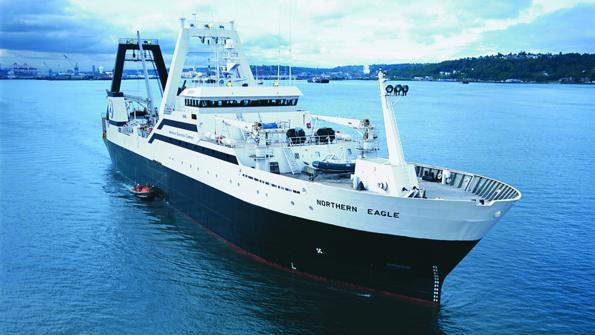

The Northern Eagle departs Seattle for a journey to the Bering Sea in search of Alaskan Pollock.
At 104-m long and 15-m wide, the Northern Eagle is the largest ship in American Seafoods’ fleet. It is also among the most modern trawler in North America. It has a crew of 140, with 90 working below deck to process as many as 54,000 fish per hour into 160 tons of finished frozen product per day.
