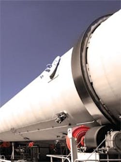

A question that remained, however, was how to drive the facility’s four massive digesters. The rotation of the digester shells, each 70-m long and 4.6 m in diameter, would be the critical element for turning raw waste into compost. Ring gears surrounding each digester that could be driven by electromechanical gearmotors were initially considered, but analysis showed that these would be prone to rapid wear.
“The fact that the waste changes volume and density at various stages of its travel through the digesters means the digester shell deflects and does not remain completely straight,” explains Kevin Jones, project manager for the SMRC. “This would create a lot of wear and tear on a conventional ring gear-and-pinion drive because continuous full-face contact would be impossible to achieve.” In other words, a traditional drive system would mean increased downtime and a heavy dependence on spare parts.
Instead, the SMRC chose a less conventional solution using low-speed, high-torque hydraulic motors from Hägglunds Drives AB, Mellansel, Sweden. Instead of gears, each drum is rotated by four pairs of rubber rollers, with two pairs of rollers mounted at each end of each digester. The hydraulic drives do not require the foundations, gearboxes, or clutches needed by electromechanical systems. Not only are the hydraulic drives simpler, but they exhibit a lower moment of inertia and can be run at infinite variations of speed.
Hägglunds delivered 16 hydraulic motors to drive SMRC’s digesters. Each motor drives a rubber tire mounted between a pair of rollers, thereby producing a high friction drive.
Results speak for themselves
Since the facility’s inauguration in 2004, the results have spoken for themselves. The friction-driven trunnion rollers, whose shafts are self-aligning, provide full-face contact that drastically reduces wear and tear. According to project manager Kevin Jones, “Our most recent measurements and predictions indicate that the driven tires will last 194 years!”
Likewise, the Hägglunds solution has protected the facility from unplanned stops in production. The drive system automatically senses load shifts and directs power to the motor that needs it most, so each digester can be operated with as few as two motors. “If one or even two motors are out of service,” says Jones, “production can still continue at a lower throughput. Damage a ring gear, and the digester would be down for months while a replacement was manufactured.”
