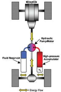

Hybrid vehicles hold great promise for the waste industry because collection vehicles have many cycles of braking and acceleration along a given route. The four Peterbilt 320 vehicles in Fort Worth use a Hydraulic Launch Assist (HLA) system developed by Eaton Corp., Eden Prairie, Minn. Brad Bohlman, business development manager of advanced technology at Eaton, says that the HLA supplements a conventional vehicle driveline with the hybrid system.
Parallel hydraulic hybrid architecture on Eaton’s HLA systems.
The system captures and stores energy during braking, which not only improves efficiency, but reduces wear on brake pads as well. Brake life is increased 2-4 times in vehicles doing frequent stops.
The stored energy is transferred to accelerate the vehicle to the next pickup location, reducing fuel consumption and wear on the engine. Bohlman says a refuse vehicle that makes 1000 starts and stops a day will achieve 19 to 28% fuel economy improvement.
