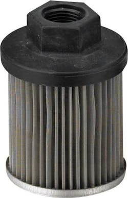

Suction filters — In the hydraulic circuit, suction filters are normally placed between the reservoir and the pump. Typically, they are designed to remove dirt particles ranging in size from 5 to 10 μm. Suction filters should not be confused with suction strainers, which serve little purpose other than to keep nuts, bolts, weld spatter, cigarette butts, and other large objects out of the pump.
It’s critical to size and maintain suction filters well. If the filter lets contaminants pass through into the pump, the pump will fail. If the filter becomes blocked, it can cause the pump to cavitate. The result will be the same — pump failure and further damage downstream of the pump.
The most popular application for suction filters is with variable-speed hydrostatic pumps, often found in mobile equipment and industrial variable-speed hydraulic drives. Suction filters used in conjunction with this type of pump will normally cause the pump to stall when blocked — before any damage
is caused by the inlet flow restriction.
Each pump manufacturer has strict criteria regarding inlet flow restrictions. These should be followed carefully when applying suction filtration. Generally, try to avoid suction filters with high flow rate pumps, particularly gear and vane pumps. Instead, clean the oil before it gets to the pump.

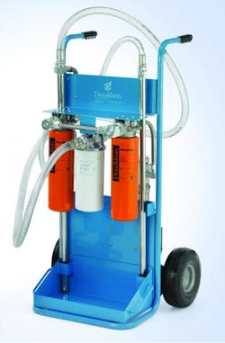

Offline (kidney loop) filters— Kidney loop filtration can be one of the most effective ways of cleaning a hydraulic system and keeping it clean. One advantage to this type of filtration is that the oil flow is nearly constant, which promotes the most efficient and reliable filter performance. Another is that the filter circuit can be serviced without having to shut down the entire system.
When using a kidney-loop filter, an additional pump is usually required at the inlet site. Considering this additional cost, built-in kidney loop filters are perhaps better suited for applications with large reservoirs of oil, or in hydraulic systems with particularly expensive components, such as servovalves. For small-tank applications, it probably makes more sense to use a mobile filter cart, which can move from one system to the next.
Careful positioning and connection of the kidney loop filter is very important to avoid stirring up dirt that may already be in the system. Ensure that the tank has proper inlet and outlet fittings that connect to the filling hoses.
With careful design, a kidney filtration unit can also be used to filter oil during the filling of the reservoir. Because a kidney filtration system does not take the full flow of the hydraulic system, and simply dilutes the dirt in the oil reservoir, aim to use the finest filtration practicable. Generally, 5 μm absolute filtration is optimal, depending on the application and the oil viscosity.
