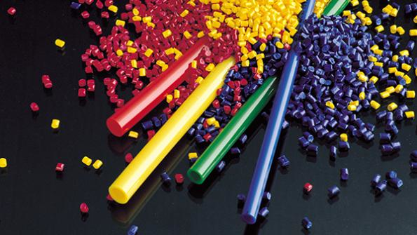

Typical materials for thermoplastic tubing commonly used in pneumatic and industrial applications include nylon, polyethylene, polyurethane, and polyvinyl chloride (PVC). And manufacturers produce many variations of these basic compounds to fit specific needs, as well as products for special uses ranging from air brakes and welding operations to food and medical-grade applications.
Polyurethane tubing is widely used because it is flexible, resists kinking, and stands up to fuels and oils.
