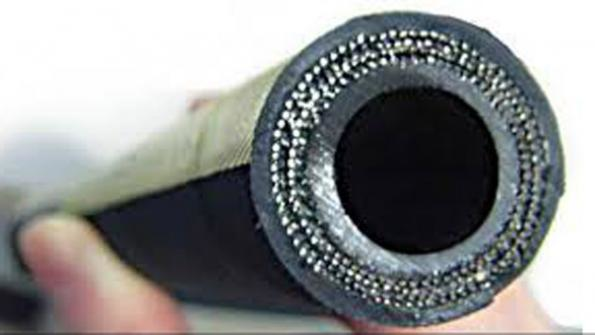

The hydraulic hose fabrication process - or more specifically - the hose cutting process introduces contamination. This comprises metal particles from the hose's wire reinforcement and the cutting blade itself, and polymer dust from the hydraulic hose's out cover and inner tube.
The amount of contamination which enters the hose during cutting can be reduced by employing techniques such as using a wet cutting blade instead of a dry one, blowing clean air through the hose as it is being cut and/or using a vacuum extraction device. The latter two aren't very practical when cutting long lengths of hose from a roll or in a mobile hydraulic hose-van situation.
Therefore the main focus must be on effectively removing this cutting residue - and any other contamination that might be present in a hydraulic hose - prior to its installation. The most efficient and therefore most popular way of doing this is by blowing a foam cleaning projectile through the hose.
The manufacturers of these cleaning systems claim that hose cleanliness levels as good as ISO 4406 15/13/10 are achievable. But like most everything else, the results achieved depend on a number of variables, which include using a projectile of the correct diameter for the hose being cleaned, whether the projectile is used dry or wetted with solvent, and the number of shots fired. Generally, the higher the number of shots, the cleaner the hose assembly. Oh, and if it is a new hose assembly that's being cleaned, the projectile cleaning should be done BEFORE the ends are crimped on.
Almost all hydraulic hose fabricators these days have and use hose cleaning projectiles. But how meticulous they are when doing it is another matter entirely. This means if you want to ensure you take delivery of hydraulic hose assemblies to a certain standard of cleanliness, it's something you must specify and insist upon - as this little story from one of our members illustrates:
