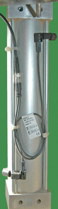

One position-sensing technique is to install external electromechanical limit switches or inductive proximity switches that detect metal targets on the moving parts of the machine. The disadvantages of this approach include the cost and complexity of the brackets and associated hardware, the difficulty of making adjustments, and the increased physical size of the overall assembly. Another problem is that the external hardware is prone to damage and misalignment from everyday incidental contact or impact.
A more popular and widely used method is to attach magnetically actuated switches or sensors to the sides of the cylinder, or into a slot extruded into the body of the cylinder. Magnetic-field sensors detect a magnet mounted in the moving piston through the aluminum wall of the cylinder. In most applications, magnetic sensors provide end-of-stroke detection in either direction; however, installation of multiple sensors along the length of a cylinder allows detection of several discrete positions.
Traditionally, two proximity switches (top) detect targets for end-of-stroke sensing. Magnetic-field sensors mounted to the cylinder (bottom) provide a more versatile and reliable switching solution. Here, reed switches are attached to tie rods.
